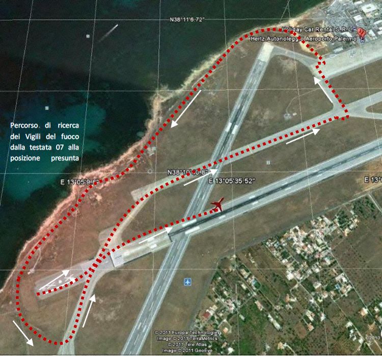

Doch es wird noch besser, denn nach dem Aufschlag kommt auch Palermo Airport ins Spiel:
30 seconds after first impact with the embankment 367 meters short of the runway threshold the Emergency Locator Transmitter activated (according to its built in stand by phase of 30 seconds), the ELT signal was received at Palermo Tower. At that point the aircraft had already come to a stop and evacuation was initiated. After all passengers were evacuated, the commander in charge also left the aircraft, the off duty commander phoned the tower and gave an approximate position of their aircraft. The passengers in the meantime, seeing lights in the distance, proceeded in the direction of those lights, a number of them arriving at the fire house and being assisted by staff there, another number arriving at the terminal and were assisted at the arrival hall.
tower provided a first estimate of the aircraft position only 5 minutes and 37 seconds after the activation of the "state of emergency", at which point it became clear to emergency crews that an actual accident had happened.
However, the poor quality of the communication on the frequency assigned to communication between tower and emergency vehicles at approximately 440 MHz, which rendered communication mostly incomprehensible contributed to further delays so that the first emergency vehicles arrived at the aircraft only 22 minutes and 5 seconds after the ELT activated.
The poor quality of communication, the excitement of staff on frequency as well as the unfamiliarity of fire crews with phraseology used by tower further contributed to the lack of overview over the rescue phase by emergency crews which led e.g. to the belief that the aircraft had gone off the runway into the sea, resources therefore being dedicated to drive along the perimeter road of the aerodrome to look for the aircraft.
The ANSV stated that none of the staff on the ground ever understood there had an accident occurred, even after 118 passengers arrived at the fire house and the terminal it did not occur to staff that an accident had happened and the airport emergency plan was still not implemented according to the accident category. Hence, for example, the passengers were all taken to the arrival hall of the airport, where they mixed with passengers from other flights, instead of the designated VIP room for post accident assistance (depriving emergency services to account for all occupants, some of whom had already left the airport and gone home).
In addition, due to accident emergency plan not being put into action, the west gate of the aerodrome remained closed. Local Emergency services, ambulances and local fire engines from the city of Palermo, could not enter the aerodrome and remained outside the aerodrome at the west gate.

Die Irrfahrt der Feuerwehr über den Flughafen erinnert stark an die Feuerwehr im Film "Die tollkühnen Männer in ihren fliegenden Kisten". :) Die Karte im Avherald-Bericht ist für mich das Highlight in dem ganzen Bericht.
